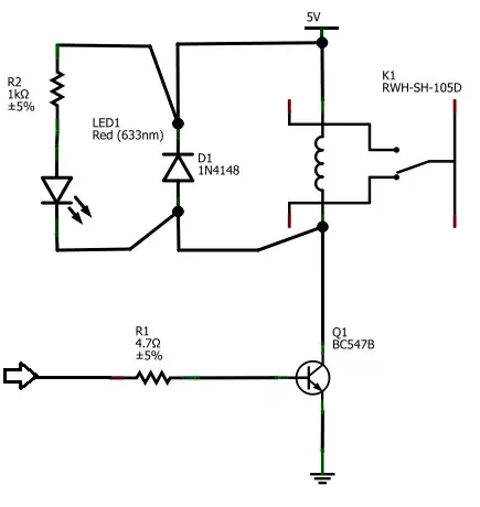

Few questions about a little Home-Automation project I am trying.
Below is the schematic which I found in an article, slightly modified to suit the parts I have in hand --
Original had,
Q1 = BC548
Relay = 12V coil voltage
Mine has,
Q1 = BC547B
Relay = 5v coil voltage
Q1) Is that an acceptable conversion ?
Note: The BC547B has Vcbo:50V, Vceo:45V, Vebo:6V, where-as the BC548 in original circuit has Vcbo:30V, Vceo:30V, Vebo:5V, rest of the parameters being pretty same as per datasheet (hFE:220-450).
The relay is the SPDT PCB-mount kind (rated for 10A @230VAC), also called "sugar cube".
my schematic
Q2) The load I am trying to drive is resistive (60W 220VAC incandescent lamp). What changes might I need if I would like to drive loads like --
  • Fluorescent lamp
  • Fan (220VAC, 60W)
  • 1HP Water pump (220VAC, 800W) -- One thought is to use higher current rated (e.g. 30A) relay. But, I think I need to worry about EM feedback which might cause arcing and destroy the EM relay.
Q3) Right now I am making this on a veroboard (el-cheapo phenolic kinds). While I understand that this may be sufficient for the lamp/fan control, I am wondering if I need something better for higher loads, s.a. the Water-pump control ? What is the minimum gauge wire to be used for this purpose ? What kind of connectors (terminal blocks) could be used ?

(Q1) Your driver is good EXCEPT
  • The base drive resistor is far too low. ee below.
  • they have used a very non standard and confusing symbol for the output contacts. I assume this is a SPDT = sngle pole double throw (= single changeover ) contact with isolation between output circuit and 5V.
The transistor may or may not be OK depending on coil current - see below.
You do not specify the coil current, but say it is 200 mA.
Icollector = Icoil = 200 mA
Ibase >> to > Icollector/Beta = 200 mA / 200 = 1 mA
I base = (Vdrive - Vbe) / Rbase or
Rbase = (Vdrive - Vbe ) / Ibase.
For Vdrive = 5V,
Rbase = (5-0.7) / 0.001 = 4300 ohms.
A resistor that gives substantially more than 1 mA is desirable 9allows beta to be low etc). So R1 = 1k = 1000 ohms would be fine.
Even with say 3V drive.
Ib = (Vdrive - Vbe)/R1 = (3-0.7)/1000 = 2.3 mA.
With a Beta of 200 Icmax = beta x Ib = 200 x 2.3 = 460 mA.
If relay current < 200 mA then 1K is stioll good.
If relay current is higher the value of R1 MAY need adjusting - probably not.

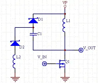

(Q2) Your basic circuit is good for load power at any sensible level, subject to suitable coil drive power AND possibly some sort of snubbing of the contacts.
The relay or contactor has to have contacts rated for the load carried - which will be in the relevant datasheet.
A "snubber" is a circuit designed to absorb transient AC energy which may othewise cause contact arcing when the contacts open. It usually consists of a series C and R such that the C limits the current to a low value in the R under normal conditions but when high voltage and/or high frequency transients occur the R current and dissipation increase and absorb the transient energy.
There have been various other stack exchange questions re snubbers eg
here & here & here & here
and there is lots of on-web resources eg
Wikipedia
Good intro
Good. Slightly more complex
Good - with online calculator
Non dissipative version (from above link)
and manufacturer of relays etc will often specify what is needed for their product with a given load.

Transistor selection:
The BC547b is rated at only 100 mA Ic. Datasheet here
This may be OK BUT a much better transistor is available which is often as cheap and sometimes cheaper.
This is the BC337 (NPN). BC327 (PNP). Also availabl in SOT23 SMD as BC817/BC807. I use these as my standard "jellybean" transistors. They will meet almost any need that you'd sensibly use them for, and in most cases a better transistor is not available without paying a lot more.
These are available in several beta ranges. I always buy the highest beta bin range = BC337-40 which has beta in the range 250 - 600 with mean of 400.
BC337-40 etc 800 mA*, 50V.
(* rated current varies with supplier 600 - 800 mA typical). 800 mA in datasheet cited).
Digikey has them at $US0.14 / 100 here Keep watch a you will sometimes ee them for far less - maybe under 5 cents in 100's.
BC337 datasheet

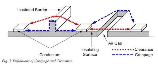

Creepage / Mains clearance
Phenolic PCB has its specialist uses but really really should be avoided for most purposes. The savings in cost are not vast compared to eg FR4 fibreglass. Phenolics main advantages are cost (minor gain) and "punchability". It is amenable to having holes or slots etc cut by punching tather than drilling or routing. In general use it is a nasty PCB material. It break and shatters. It risks breakdown. It is not fire or moisture proof. Caveat emptor!
Excellent creepage & clearance page here
Excellent TI power supply safety design paper here - Image from this shown below.
Excellent creepage & celarance page here.
Note they say:
  • When designing a switch-mode power supply for use in information technology (IT) equipment, a typical rule of thumb is to allow an 8-mm creepage distance between primary and secondary circuits, and a 4-mm distance between primary and ground. If these dimensions are allowed for during the design stage, there is a high probability (95%) that no failure will occur with respect to creepage or clearance when the final product is submitted for test.
All the above are liable to lead you to conclude that my advice was too conservative and that you can use lower limits with Vero board. It wasn't. You can't with any safety.

  • @icarus74 - It's probably worth noting that if your relay is rated to switch inductive loads (e.g. a motor, etc..), you can skip the snubber. You can also skip the snubber if your load is non-inductive (such as a light-bulb). It's probably far easier to just buy power-rated relays then build a snubber. – Connor Wolf Jan 23 '12 at 08:22
  • (To clarify, I am talking about the snubber on the load. You will always need at least the back-emf diode on the relay (this is the diode connected across the relay coil)) – Connor Wolf Jan 23 '12 at 08:24
  • @RussellMcMahon, thanks for stressing on safety factors. That is indeed what I wanted to know. Are there any such concerns if I take a DIY PCB route, on phenolic copper-clads, while honouring the min. trace width, and clearance between traces / connectors / leads etc. ? Should it be some kind of a cut-out (s.a. physical gaps) in the PCB that separates the AC / DC nets ? I've seen such recommendation, but can't seem to visualize how it is to be achieved. – bdutta74 Jan 23 '12 at 12:16
  • Thanks @FakeName. Reading around, I'd got the impression that snubber circuits are desirable, even if the relay is sufficiently rated, however I am not familiar with "power-rated relay" i.e. if they are superior to say what I have in hand, in form of this relay – bdutta74 Jan 23 '12 at 12:20
    @icarus74 - some relays explicitly specify in their datasheets that they can handle inductive loads. It's worth noting that even if you have a relay that is specified to handle inductive loads, a snubber will improve it's cycle life. However, it's also additional trouble to construct. A snubber is generally a good idea for inductive loads. however, it's not essential. – Connor Wolf Jan 23 '12 at 12:24
    @icarus74 - Phenolic PCB has its specialist uses but really really should be avoided for most purposes. The savings in cost are not vast compared to eg FR4 fibreglass. Phenolics main advantages are cost (minor gain) and "punchability". It is amenable to having holes or slots etc cut by punching rather than drilling or routing. – Russell McMahon Jan 23 '12 at 13:07
  • Thanks @FakeName. Probably because I have been looking at the lower-end (price wise) of the EM relays, I might not have come accross the ones whose datasheet states that they are good for inductive loads as well. In fact, most of the relay datasheets I've seen so far are 1 or 2 page long, and not very rich in information. If you are aware of any specific part, or make/series that might fit the bill would appreciate if you could point to it. – bdutta74 Jan 23 '12 at 13:16
  • @RussellMcMahon, sincere gratitude. That's a mighty information packed link and graphic. I see what you mean (and the other articles meant) now. The phenolic / protoboard approach was only for prototyping, and once I got everything working, I was anyway planning to go for professionally done PCBs on FR4, probably with solder-mask, silk-screen and all. I was looking for a relatively safe (i.e. engineer handled) way to prototype. – bdutta74 Jan 23 '12 at 13:24
