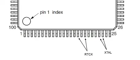

I'm routing a breakout board for NXP's LPC23xx microcontroller. This MCU requires two crystals if one is using the RTC. These two crystals connect to the MCU with only 3 pins in between:
LQFP-100 package with crystal pins indicated
From this question, it is clear that "as close as possible" is the recommended distance, but there are tradeoffs to be made, especially when dealing with two different crystals that must be connected "as close as possible" and with traces that are "as symmetrical as possible".
In my particular design, I'd like to use rather large crystal packages (TC38 for the RTC and SM49 for the 12 MHz) for cost reasons, but even with much tinier packages, layout is not simple.

How should I prioritize these factors? Should I sacrifice trace symmetry in order to minimize the length of one of the traces? Should I make the traces as symmetrical as possible, even if that means that the traces will be ~12mm long? Further, which of these crystals should I place closer, assuming I can choose one to be close and one to be further away?

For either of those parts 50 mils (~1.3 mm) of difference in length would be just fine. I would rather see you give up some there rather than have the crystal 12 mm away.

    It's important to note that because of the location of the pins, one or the other crystal will have to be significantly farther than the other. Furthermore, the package of the 12 MHz crystal itself is something like 10mm wide. – Mark Sep 29 '11 at 20:04
