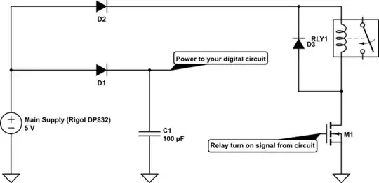

The reason with a relay and a capacitor and shared power things go wrong, still, is because the current spike of your relay is too large for the capacitor to help with and then the cables can't keep up either, or because the relay release creates a voltage spike. A solution could be, if your design can handle a diode-drop:
schematic
D1 prevents anything powered by the DR832 from stealing power from your digital buffering capacitor C1. D2 prevents the relay from making any significant noise on your supply and D3 catches any power spikes the relay still makes when you turn it off.

A quick long-winded comment regarding the "snubber" diode D3 that is (or should be) in parallel across relay RLY1's coil (see the schematic figure in @Asmyldof's reply).
If that diode is installed backwards--i.e., if the diode's anode (+) lead is connected to the +5 VDC rail (i.e., the Rigol's '+' output terminal), then when N-MOS transistor M1 turns ON you will effectively crowbar (short circuit) the power supply's '+' and '-' output terminals through D3 and M1, which would definitely cause the circuit to "reboot". Specifically, when M1 turns ON and the +5 VDC rail short circuits to ground through D3 and M1, the voltage on the +5 VDC rail drops to near zero volts (voltage "brown out"), which turns OFF the microcontroller (or other digital control circuitry), at which point the voltage on M1.GATE (possibly, see note 1) drops below M1's gate-source threshold voltage VGS(th), thereby shutting M1 OFF. Now that M1 is OFF, the D1+M1 crowbar across the power supply rails is removed, the potential on the +5 VDC rail restores to +5 VDC relative to GROUND, and nominal circuit operation is restored.
TL;DR. In your circuit, ensure that snubber diode D3 is present, and that D3's cathode lead is connected to the +5 VDC rail exactly as shown in @Asmyldof's schematic.
(Note 1) I would also install a 10 kohm pull down resistor between M1's gate and ground as a contingency plan to bring M1.GATE low (~0 VDC) when nothing else is actively driving M1's gate-source voltage VGS. Recall that M1 is an N-type enhamcement mode MOSFET, and if VGS < VGS(th) then M1 will shut OFF. The pull down resistor's job, therefore, is to create a default gate-source voltage that is well below M1's VGS(th) voltage--i.e., to create a default condition of VGS << VGS(th)--when no other circuitry is actively driving the gate-source voltage on M1. (Specifically, the pull down resistor provides a means of discharging to ground any non-zero potential on M1.GATE.)
Some futher elaboration on the pull down (or pull up) resistor concept. Assume (1) neither a pull down nor pull up resistor is connected to M1.GATE, and (2) a microcontroller's digital I/O (DIO) output pin is connected to M1.GATE. Ask yourself this question: what is M1's operating state when the microcontroller's DIO pin is configured for high-impedance (HIGH-Z) mode--i.e., when both of the DIO pin's active drive output transistors are turned OFF and the microcontroller is not actively driving any voltage onto M1.GATE. It's almost as if the wire between the DIO pin and M1.GATE was removed and now the potential on M1.GATE is left to float relative to the ground potential. In this situation you have no idea what VGS is. To make matters worse, when the DIO pin is in this HIGH-Z mode, any nearby electric/electrostatic fields, circuit noise, etc. can now affect the potential on M1.GATE (i.e., VGS) and can literally cause M1 to randomly turn ON/OFF. Placing a pull down resistor between M1.GATE and ground helps to anchor VGS at a default voltage of ~0 VDC--which is well below VGS(th)--when nothing else is activly driving a voltage onto M1.GATE. (Note that if you wanted M1 to be ON by default, you would instead connect a pull up resistor between M1.GATE and the +5 VDC rail. This assumes, of course, that M1.VGS(th) << +5 VDC.)
TL;DR. Whenever a MOSFET is used as a switch, ensure a pull down or a pull up resistor is in place to establish a default VGS voltage for the case where no other circuit elements are actively driving the VGS voltage.
