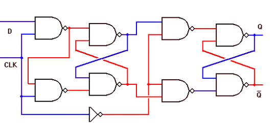

  • @WoutervanOoijen I agree it would be a good idea for the OP to clarify in his question that he wants edge-triggered clocked SR flip-flops. Actually all of the the current answers (including mine, which I deleted) used latches. I will concede the OP did say flip-flop in his original post, not latch, and I didn't pick up on the difference. This is an edge-triggered flip-flop -- note that it requires two SR latches in series. – tcrosley Feb 19 '15 at 17:47

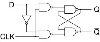

The explanation stated is for a simple Set-Reset FF (or latch, or how you want to call it). A level-triggered circuit (I would call that a Latch) can be thought of as a RS-FF with both inputs gated by the enable input (CLK in this diagram):
In this circuit, a simulatenous 00 -> 11 transition of the hidden 'inputs' of the cross-coupled NANDS still causes a race condition. Such a transition can occur (due to the delay caused by the inverter) when the D input changes simultaenously with the CLK input changing from 1 to 0.
A real clocked (edge-triggered) memory circuit can be thought of consisting of two latches, enabled by the opposite clock levels (master-slave arrangement). Obviously the first latch is still susceptible to the same race condition.

  • The picture you added is not an edge-triggered SR flip-flop (which is the topic of this question), it's an edge-triggered D flip-flop. See the image I linked to in the comment under the question, that's an edge-triggered SR flip-flop. I don't know why you are bringing in D flip-flops at this point. Your comment above the bottom picture about the first latch being susceptible to the same race condition obviously doesn't apply to D flip-flops, the two inputs to the latch can never both be 1. – tcrosley Feb 19 '15 at 18:02
  • They can, for a brief moment, due to delays. And a brief moment is all that it takes to get a (possible) metastable situation. – Wouter van Ooijen Feb 19 '15 at 18:36
  • Assume the D flip-flop, not if you let the D input settle before applying the clock pulse. At that point, the two inputs to the first set of NAND gates are stable. – tcrosley Feb 19 '15 at 18:46
  • @tcrosley: Of course, when you obey the setup & hold times, you have neither race condition nor metastable behaviour. That is why setup & hold times exist! – Wouter van Ooijen Feb 19 '15 at 21:24

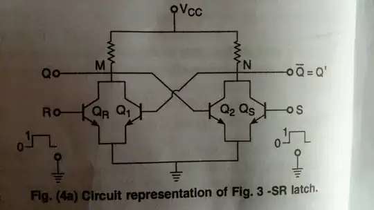

All the answers enter image description here
Firstly its not race around condion....don't confuse it....its Race Condition.....
When S=R=1 Q=Q'=1. Its well defined..but the problem arises when both S and R changes simultaneously to 0 from 1(high to low)
The transistors will try to come out of saturation...
Now both transistors Qr and Q's will try to come out of saturation...but as the saturation delay if the transistors can rarely be equal in mass production...the transistor with less saturation delay will win..and will latch the circuit...
If Qr is faster then voltage at M will fall and Q=0 If Qs is faster then voltage at N will fall and Q'=0
Thus output is unpredictable
Even if speeds are equal then also outputs Q and Q' will oscillate between 1 to 0 and then 0 to 1 Thus output is unstable...

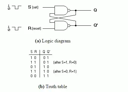

For your case :
Consider what will happen if both S and R are high.
Assume q = 0 and q' = 1 initially. Then
If A arrives before B , Q will change to High which will momentarily set Q' low which in turn should have ideally kept Q high and so on.
Now after a moment, B arrives ( very short duration). This will turn Q' High which in turn will set Q High.
You can check to see what happens when B arrives before A.
Now actually, there are 2 things happenning here :
1) The output depends momentarily on which input arrives first. This in essence is the race condition.
2) The final state is q = 1 and q' = 1 . This is NOT race condition. This is merely an invalid state. Ideally, Q and Q' must be opposite, which is not the case here.

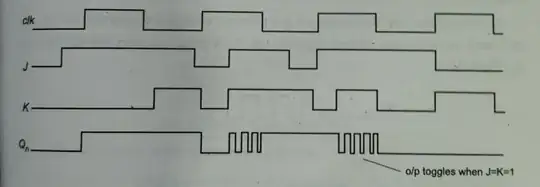

Whenever we provide 1 to both J and K in the JK Flip Flop, the output is supposed to complement the previous output. This is called race around condition(similar to the same concept in "operating system", where the final output depends on the sequence by which processes are executed).
To overcome this problem, we use master-slave flip flop.

Race around condition only exists in latches as they are level triggered devices and clock pulses may remain high for a period where for invalid inputs the output fluctuates indefinitely until the clock pulse is high. This is eliminated by using master slave latches (JK) or flip flops which are edge triggered devices.
