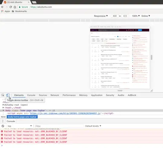

Chromium / Chrome
Toggle the Device Mode button to turn Device Mode on or off. When Device Mode is on, the icon is blue (IMG: ). When Device Mode is off, the icon is gray (IMG: ). Select More tools -> Developer tools -> click Toogle device toolbar button (marked by the mouse cursor in the below screenshot -> click the black downward triangle ▾ to the right of "Responsive" to show the dropdown menu and select your device from the dropdown menu.
