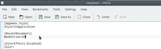

KDE Forums - Feature Request: More Recent Documents : https://forum.kde.org/viewtopic.php?f=251&t=131544#p353228
by "google01103":
try editing the kdeglobals file (in ~/.kde[4]/share/config or in ~/.config depending on what you're running) the following section
   [RecentDocuments]
    MaxEntries=20
  • KDE4: ~/.kde/share/config/kdeglobals
  • KF5: ~/.config/kdeglobals
Editing the kdeglobals with the kwriteconfig / kwriteconfig5: KDE Forums - Howto: Recently used: https://forum.kde.org/viewtopic.php?f=67&t=119324#p301110
Note ! Use the right tool:
  • kwriteconfig is the KDE4 tool.
  • kwriteconfig5 is the KDE Frameworks5 (KF5) tool.
