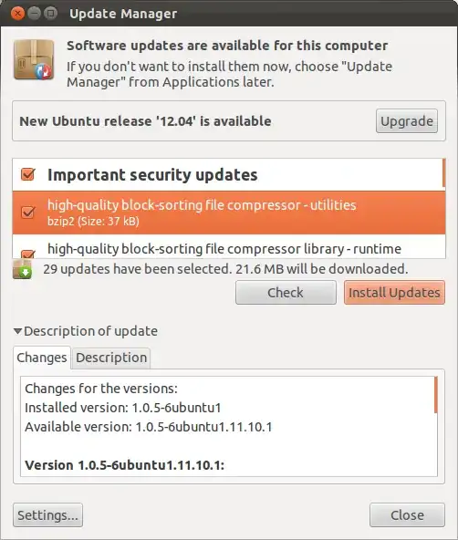

You can upgrade inside of Ubuntu.
To do that, press Alt + F2 and run the following command:
update-manager -d
You should see a window similar to this:
Click on the 'Upgrade' button and start the upgrading process.
