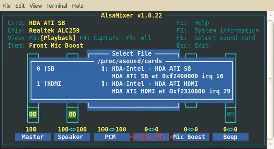

My speakers work correctly, but when I plug in my headphones, they don't work. I am running Ubuntu 10.04.
My audio card is Realtek ALC259 My laptop model is a HP G62t a10em
In another thread someone fixed a similar issue (headphones work, speakers not) folowing this:
sudo vi /etc/modprobe.d/alsa-base.conf (or some other editor instead of Vi) Append the following at the end of the file:
alias snd-card-0 snd-hda-intel options snd-hda-intel model=auto
Reboot
but it doesnt work for me.
Before making and changes to alsa, this was the output:

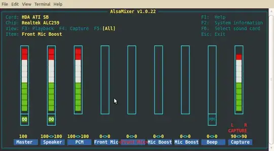

alsamixer gives me this: alsamixer output Audio card is a HDA ATI SB
Things I did: followed this HowTo but now no hardware seems to be present (before, there were 2 items listed): sound preferences - hardware tab is empty
Now, alsamixer gives me this:

Open a terminal, run alsamixer and check for any muted channels which could cause this. Other than that some details on the make of your soundchip and hardware wouldn't hurt.
nem75
  • 1,669
