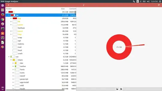

recently I installed ubuntu 16.04 on my HP ProBook 440 G3 on a 30 GB partition. But after using some days the whole disk just filled up. I have used 16.04 on just 10 GB space on a different PC without any problem. I have added the screenshot of root directory. please let me know how to fix this problem.

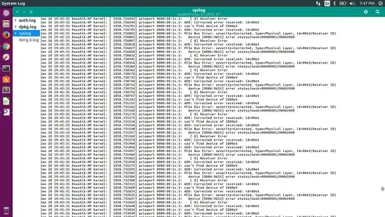

I checked the syslog and found a file is constantly updating , added the screen shot. I don't understand what is the problem here. Also these are the lines I see when I boot up. Also added the lspci output
screenshot
