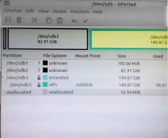

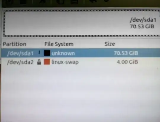

And in GParted:

Your NTFS partition is broken. In order to restore the data, you need to make a copy of it (ideally) and then use a NTFS reconstruction software to restore its contents.
