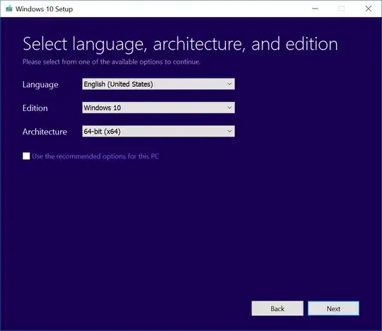

- Uncheck "Use recommend options for this PC" and select what options you need, then select "Next".

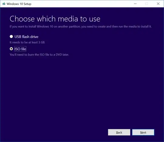

- Choose the option "ISO file" and select "Next".

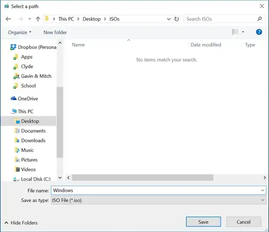

- Make a new folder on your desktop labeled "ISOs" and save the ISO file to the ISO folder on your desktop.
- Wait until the ISO file has successfully been created and close the program.

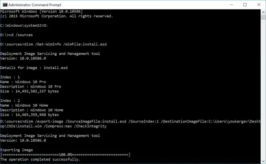

- Run Administrator Command Prompt.
- Navigate to the WIM file location by changing to volume and using the "cd" command.
D: Note: Make sure you use the drive letter of your mounted iso.
cd /sources
- Now we need to get information about the ESD file to convert it to a WIM file.
dism /Get-WimInfo /WimFile:install.esd
- Convert the ESD file to a WIM file using DISM and save it to the ISO folder.
C:\Users\youkergav\Desktop\ISOs Note: Change "youkergav" to your username so the path is correctly specified.
- Once the image export is successful, close command prompt.

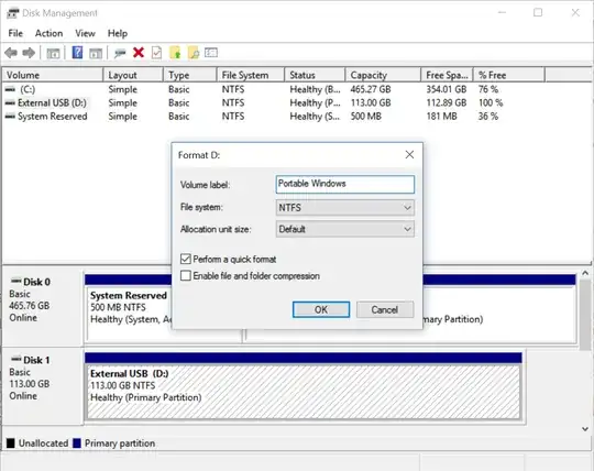

- Plug in you external hard drive and launch "Disk Management"
- Locate the external hard drive and format the drive to NTFS with the label as "Portable Windows" Note: Be aware this will delete all the contents of the drive.

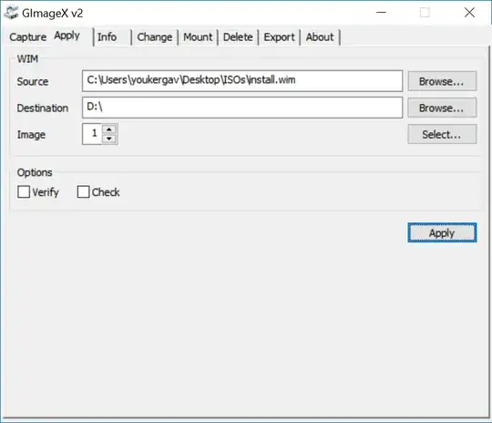

- Download and install GImageX.
- Open GImageX and go to the "Apply" tab.
- Browse for the source. This is the WIM file that is located on the desktop folder "ISOs".
- Browse for the destination. This will be the "Portable Windows" drive we just formatted.
- Select "Apply" and wait for GImageX to apply the image to the drive.

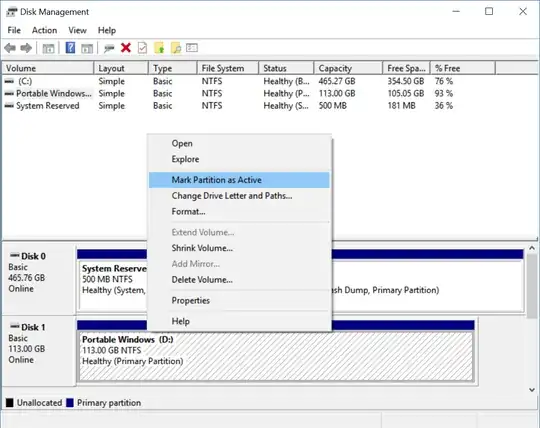

- Go back to Disk Management and make the partition active.

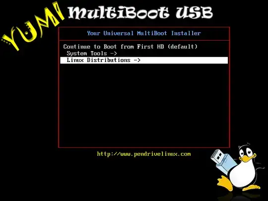

- Boot to the flash drive from the BIOS.
- From the YUMI bootloader, select "Linux Distributions" and boot Ubuntu.

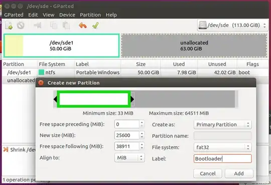

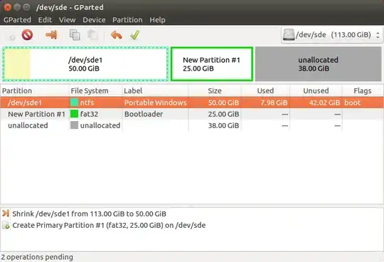

- Open the program "GParted" and select the device location of your external hard drive.
- Right click and select "unmount" on the partition.

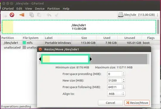

- Right click on the partition and select "resize/move".
- Resize the partition to 50 GB (51200 MB).
- Right click on the unallocated space and select "new".
- Make the partition size 25 GB (25600 MB). Format the drive to FAT32 and label the filesystem "Bootloader".
- Click the check mark to apply changes.

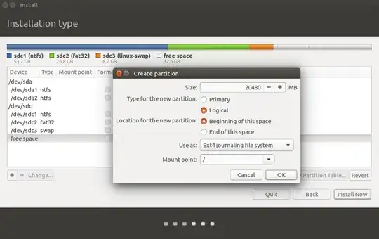

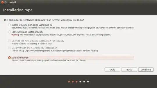

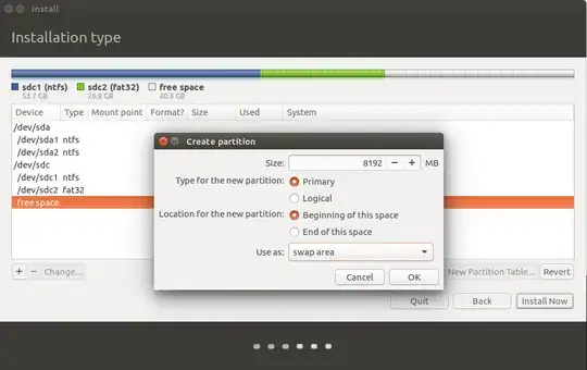

- Select the option "Something Else"
- Find your external drive path and click the free space then "+".

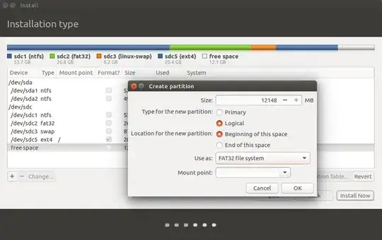

- Add a swap partition with 8 GB (8192 MB). Make the partition a primary partiton
- Click on the free space again, followed by clicking "+".
- Add 20 GB (20480 MB) logical partiton, mounted on "/".
- Use the remaining space as portable storage.
