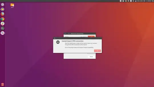

I am trying to import a .ovpn file from the network manager. Here are the steps I follow.
Network Manager → VPN Connections → configure VPN
This opens the Network Connections dialogue. Then,
Add → import saved vpn configuration → choose .ovpn file
This should load my .ovpn configuration, but instead I get a prompt saying
ERROR: plugin does not support import capability.
I can still use VPN using the command
sudo openvpn --config ~/openvpn/xxx.conf
is this a bug that needs to be filed?
