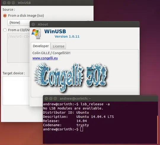

The Winusb package is not available from this PPA for Wily but there is a technique that worked well on my system to install it using the Saucy package. I have tested this under Trusty but it should also work under Wily:
Firstly download either 64bit or 32bit package from the PPA:
64bit:
wget https://launchpad.net/~colingille/+archive/freshlight/+files/winusb_1.0.11+saucy1_amd64.deb
32bit:
wget https://launchpad.net/~colingille/+archive/freshlight/+files/winusb_1.0.11+saucy1_i386.deb
Then install the file:
sudo dpkg -i winusb_1.0.11+saucy1*
You will see errors such as the following:
andrew@corinth:~$ sudo dpkg -i winusb_1.0.11+saucy1*
(Reading database ... 197467 files and directories currently installed.)
Preparing to unpack winusb_1.0.11+saucy1_amd64.deb ...
Unpacking winusb (1.0.11+saucy1) over (1.0.11+saucy1) ...
dpkg: dependency problems prevent configuration of winusb:
 winusb depends on libwxbase2.8-0 (>= 2.8.12.1); however:
  Package libwxbase2.8-0 is not installed.
 winusb depends on libwxgtk2.8-0 (>= 2.8.12.1); however:
  Package libwxgtk2.8-0 is not installed.
 winusb depends on gksu; however:
  Package gksu is not installed.
dpkg: error processing package winusb (--install):
 dependency problems - leaving unconfigured
Processing triggers for man-db (2.6.7.1-1ubuntu1) ...
Processing triggers for gnome-menus (3.10.1-0ubuntu2) ...
Processing triggers for desktop-file-utils (0.22-1ubuntu1) ...
Processing triggers for bamfdaemon (0.5.1+14.04.20140409-0ubuntu1) ...
Rebuilding /usr/share/applications/bamf-2.index...
Processing triggers for mime-support (3.54ubuntu1.1) ...
Errors were encountered while processing:
 winusb
andrew@corinth:~$
Fix the errors:
sudo apt-get -f install
It is a very clumsy method (and certainly will not work for all deb packages!) but has certainly worked on my Trusty system and should also work on Wily:
