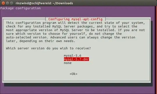

This worked for me:
wget https://dev.mysql.com/get/mysql-apt-config_0.8.10-1_all.deb
sudo gdebi mysql-apt-config_0.8.10-1_all.deb
sudo apt-get update
sudo apt-get install mysql-server
The 2nd command will ask for input:
After picking 5.7 choose "apply"
$ mysql --version
mysql  Ver 14.14 Distrib 5.7.8-rc, for Linux (x86_64) using  EditLine wrapper
Don' forget to run mysql_upgrade after installation to upgrade system tables and restart server, following MySQL Upgrading guide.
$ mysql_upgrade
or
$ sudo mysql_upgrade -u root -p
And restart mysql
sudo service mysql restart
