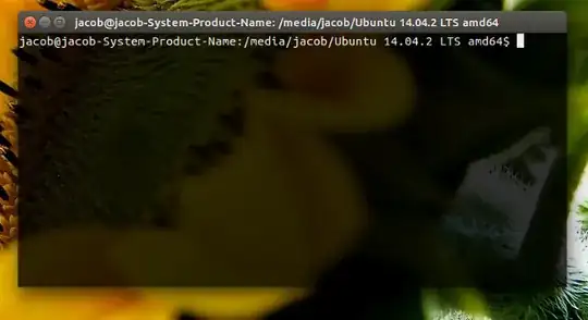

An edited version of this script does the job. When a (any) usb device is being connected, a gnome-terminal is opened in its (root) directory.
In the example, when a 14.04 usb startup flash drive is connected:
