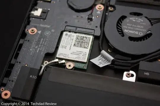

None of the other solutions solved the problem, and recently, I found out, that this is a hardware problem:
When I carry around my laptop it usually shakes, and bends a bit, this is causing the faiure!
I can provoke the fail by bending the bottom of the screen a bit to the back on one side and pull to the front on the other side. not strong, just a tiny bit without hurting the device.
After some tries, the Wifi card dies.
The same problem on my gaming Windows partition.
So the solution is only to put the device in a safe place and don't change the angle of the screen, then the Wifi Card will stay active without problems.
Maybe it is caused by the Aux and Main connectors touching the case, when you bend it, the Wi-Fi card is located on the left side, just above the battery:
I tried to replyce the wifi card with this guide: http://techdadreview.com/2014/09/02/upgrade-lenovo-yoga-2-pros-wireless-card/
But I found out that the problem is not the WiFi card itself, but it is the long part of the motherboard next to it. Whenever you slightly press on that platine, the WiFi card dies.
So I will try to buy a small USB card now and meanwhile I will be cautious that I do not press too hard on the bottom of my laptop .
