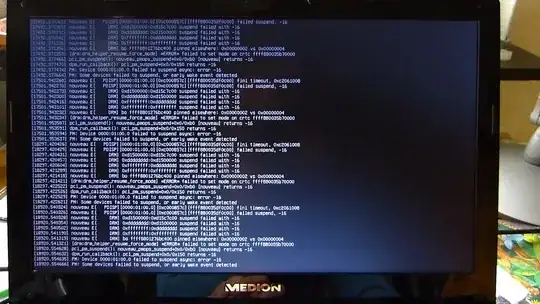

Now when i press Standby in the menu or on my Keyboard, the display turns black for a few seconds, then some messages appear for a very short moment on the screen. After that, the the log-in screen appear. Two times I was able to enter Standby but the other times it fails.

Usally I got only a half or one third of the screen filled with messages like that. This time, when I filmed it, it was much more.

You are using the default nouveau driver, for your nvidia graphics card. This is a reverse engineered driver and is known to cause trouble with power management. From what I can tell from my experience suspend with nouveau is gambling, depends very much on the kernel version, graphics card etc.
The first thing I would try if I were you is installing the official nvidia driver: Note, though, it is proprietary, but I would try to see if it resolves your problem, because then we know pretty much for sure nouveau is the component to blame. (Looking at all the errors on your screen I am pretty sure though nouveau is the trouble maker.) If you have concern because the proprietary driver is closed source, you can set up a second ubuntu install on an external hdd/usb and try it there.

EDIT: Please also paste the output of
lspci
since the error message on your screen says "Device 0000:01:00.0 failed to suspend" and that command helps us to find what device exactly that is, but I suppose your graphics card.
