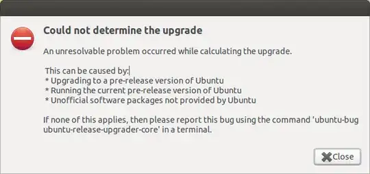

I am having an issues upgrading to 14.04 (Trusty Tahr) from 13.10 (Saucy Salamander), where I get a message Could not calculate the upgrade, and I believe it is due to my unofficial software packages. Can someone please suggest which packages I should resolve, and how to resolve these packages? My question is similar to this one here, but I need help in implementing the solution that resolves the packages.
I already unchecked all packages under "other" in the Software and Updates menu while trying to upgrade through Software Updater.
Running a grep Broken /var/log/dist-upgrade/apt.log showed me multiple packages, but I'm not sure which ones are broken and how to resolve them before upgrading. I suspect my configuration with Bumblebee and Nvidia Optimus has added some PPA's and other non-supported software.

# newer versions of the distribution.
deb http://us.archive.ubuntu.com/ubuntu/ saucy main restricted
deb-src http://us.archive.ubuntu.com/ubuntu/ saucy main restricted
## Major bug fix updates produced after the final release of the
## distribution.
deb http://us.archive.ubuntu.com/ubuntu/ saucy-updates main restricted
deb-src http://us.archive.ubuntu.com/ubuntu/ saucy-updates main restricted
## N.B. software from this repository is ENTIRELY UNSUPPORTED by the Ubuntu
## team. Also, please note that software in universe WILL NOT receive any
## review or updates from the Ubuntu security team.
deb http://us.archive.ubuntu.com/ubuntu/ saucy universe
deb-src http://us.archive.ubuntu.com/ubuntu/ saucy universe
deb http://us.archive.ubuntu.com/ubuntu/ saucy-updates universe
deb-src http://us.archive.ubuntu.com/ubuntu/ saucy-updates universe
## team, and may not be under a free licence. Please satisfy yourself as to
## your rights to use the software. Also, please note that software in
## multiverse WILL NOT receive any review or updates from the Ubuntu
## security team.
deb http://us.archive.ubuntu.com/ubuntu/ saucy multiverse
deb-src http://us.archive.ubuntu.com/ubuntu/ saucy multiverse
deb http://us.archive.ubuntu.com/ubuntu/ saucy-updates multiverse
deb-src http://us.archive.ubuntu.com/ubuntu/ saucy-updates multiverse
## N.B. software from this repository may not have been tested as
## extensively as that contained in the main release, although it includes
## newer versions of some applications which may provide useful features.
## Also, please note that software in backports WILL NOT receive any review
## or updates from the Ubuntu security team.
deb http://us.archive.ubuntu.com/ubuntu/ saucy-backports main restricted universe multiverse
deb-src http://us.archive.ubuntu.com/ubuntu/ saucy-backports main restricted universe multiverse
deb http://security.ubuntu.com/ubuntu saucy-security main restricted
deb-src http://security.ubuntu.com/ubuntu saucy-security main restricted
deb http://security.ubuntu.com/ubuntu saucy-security universe
deb-src http://security.ubuntu.com/ubuntu saucy-security universe
deb http://security.ubuntu.com/ubuntu saucy-security multiverse
deb-src http://security.ubuntu.com/ubuntu saucy-security multiverse
## Uncomment the following two lines to add software from Canonical's
## 'partner' repository.
## This software is not part of Ubuntu, but is offered by Canonical and the
## respective vendors as a service to Ubuntu users.
# deb http://archive.canonical.com/ubuntu saucy partner
# deb-src http://archive.canonical.com/ubuntu saucy partner
## This software is not part of Ubuntu, but is offered by third-party
## developers who want to ship their latest software.
# deb http://extras.ubuntu.com/ubuntu saucy main
# deb-src http://extras.ubuntu.com/ubuntu saucy main
deb http://repository.spotify.com stable non-free
# deb-src http://repository.spotify.com stable non-free
modulitos
  • 699
To upgrade the core system packages to Trusty, simply run the following:
sudo sed 's/saucy/trusty/g' -i /etc/apt/sources.list
sudo mv /etc/apt/sources.list.d /etc/apt/sources.list.d.bak
sudo apt-get update
sudo apt-get dist-upgrade -y
To upgrade your PPAs, you can either manually select the ones to enable, or do the following:
sudo mv /etc/apt/sources.list.d.bak /etc/apt/sources.list.d
sudo sed 's/saucy/trusty/g' -i /etc/apt/sources.list.d/*
sudo apt-get update
I've been upgrading my machines like this for years now without any problems. Sometimes you need to run dist-upgrade a few times, or some new package may overwrite a file that APT refuses to do, so in those cases you can manually dpkg --force-overwrite those packages if you come across them.
mmstick
  • 1,977
Well, I too had a lot of broken packages. I just downloaded the 14.04 ISO and installed with the preserver data option. It preserves all your data, but it will delete all non-supported packages.
But when you reinstall them, their data is not lost.
The above applies, of course, if your /home and / are on different partitions. If they are on the same partition, you'll either want to back up /home, reinstall and restore or fix your packages.
Also try:
$ sudo apt-get install --fix-broken
That will clean up as much as it can.
Happy to help.
xyz
  • 1,836
Executing the following command solved the problem for me and I proceeded successfully with the upgrade:
sudo apt-get remove xserver-xorg-video-nouveau
tamers
