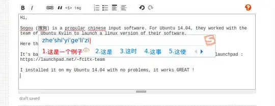

SOGOU (搜狗) is a popular Chinese input software. For Ubuntu 14.04, they worked with the team of Ubuntu Kylin to create a linux version of their software.
It's based on FCITX input software, which is developed by the FCITX TEAM on launchpad.
I installed it on my laptop with Ubuntu 14.04 without any problem, and it works GREAT!

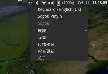

On the left Ubuntu 14.04, on the right LUBUNTU 14.04 (fcitx app indicator) enter image description hereenter image description here
If I run $fcitx-qimpanel then it seems to improve on LUBUNTU, but I still cannot choose the SOGOU entry from the menu :
When I select the SOGOU entry in the menu, NOTHING happen. It's when I click on the fcitx icon that the message appears in the terminal.
