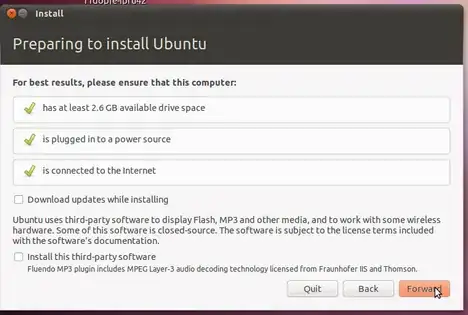

    While installing Ubuntu 12.04 I had to check the mark which shows to install additional third party softwares and drivers during installation:
Check the box which says Install third party softwares.
