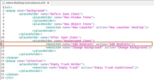

Edit as per comment to remove "Add Desklets" action.
7) Edit the file "nemo-desktop-icon-view-ui.xml" to remove "Add Desklets" action.
Search for the line number "12" to delete it.
You can remove it with your favorite editor or with this command:
  • sed -i '/Desklets/d' ~/Downloads/src/nemo-1.8.4-20130709192207/src/nemo-desktop-icon-view-ui.xml

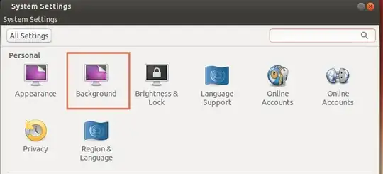

10) Enable the "gnome-control-center-unity-appearance.desktop" file to appears in the gnome-control-center.
  • sudo sed -i.bak 's/OnlyShowIn=Unity;/OnlyShowIn=Unity;GNOME;/g' /usr/share/applications/gnome-control-center-unity-appearance.desktop
11) Hide the "gnome-background-panel.desktop" file from the gnome-control-center.
To avoid this:
  • sudo sed -i.bak 's/OnlyShowIn=GNOME;/NotShowIn=GNOME;/g' /usr/share/applications/gnome-background-panel.desktop

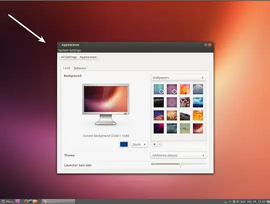

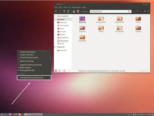

The Result:
As you can see the menu does not have the "Add Desklets" action and the "Change Desktop Background" will open the gnome-control-center appearance
