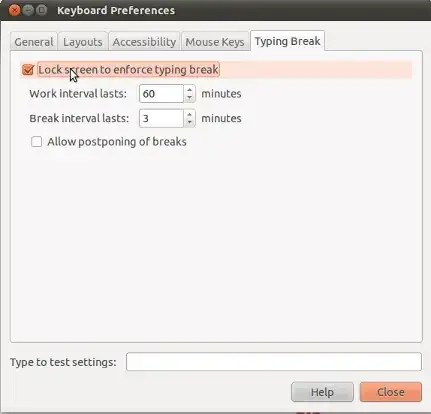

You can define a keyboard lock (typing break) in System->Preferences->Keyboard:
However with this settings the total time a user worked without a break are neither logged nor displayed.

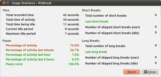

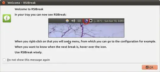

RSIBreak. (Click To Install)
Repetitive Strain Injury (RSI) is an illness which can occur as a result of continuous work with a mouse and keyboard. The risk of suffering injury increases the longer users work without breaks. RSIBreak simply offers reminders to take a break now and then.
After the start it will show up in your system tray and will monitor your activity. Whenever it detects that you have been active for a certain amount of time (configurable) it will prompt you for a break. It has some settings so if you walk away from your keyboard, it can reset the timers, so you will not be bothered with a break right after you return from that coffee break.
You can setup RSIBreak to popup a tiny notification popup to remind you to take a break, but you can also configure it to black out your screen so you can not continue working. All to your liking.
