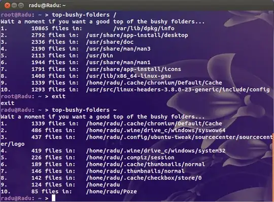

You can check with this script:
#!/bin/bash
if [ $# -ne 1 ];then
  echo "Usage: `basename $0` DIRECTORY"
  exit 1
fi
echo "Wait a moment if you want a good top of the bushy folders..."
find "$@" -type d -print0 2>/dev/null | while IFS= read -r -d '' file; do
    echo -e `ls -A "$file" 2>/dev/null | wc -l` "files in:\t $file"
done | sort -nr | head | awk '{print NR".", "\t", $0}'
exit 0
This prints the top 10 subdirectories by file count. If you want a top x, change head with head -n x, where x is a natural number bigger than 0.
For 100% sure results, run this script with root privileges:
top-bushy-folders
Radu Rădeanu
