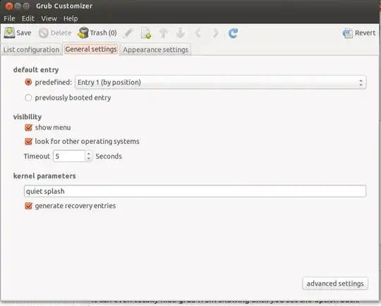

grub-customizer can do this for you.
It can even totally hide grub from showing until you set the option back. The show menu makes it boot directly to the predefined option if you deselect it:
The delete button is greyed out but lets you remove option from grub in the 1st tab. Don't use it: hiding the menu is a lot safer.

You can use grub-customizer to manipulate the grub table in all kinds of ways and it has a graphical interface that is kinda easy to use. Just use
sudo add-apt-repository ppa:danielrichter2007/grub-customizer
sudo apt-get update
sudo apt-get install grub-customizer
I used it to tidy up the list (putting all besides Ubuntu and Win7 in a folder in the menu) and change the resolution of the screen since it was at 800x640 for some reason
