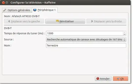

6. Check with your TV application if the USB TV Tuner is recognized
I personally use Kaffeine Install kaffeine.
In tab Television | Configure TV, I get a new tab called Peripherique 1.
enter image description here Note that for French TV, it is necessary to set the source with a shift of 167khz.
