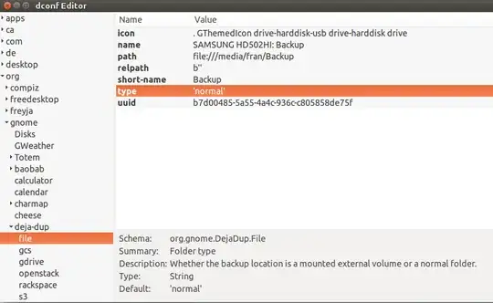

Ok, I've found a workaround for this. First, you need to have installed dconf-editor:
sudo apt-get install dconf-editor
Then run it and open org/gnome/deja-dup/file. There, change the "type" from "volume" to "normal"
Alternatively you could just execute this command:
dconf write /org/gnome/deja-dup/file/type "'normal'"
