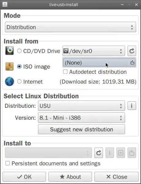

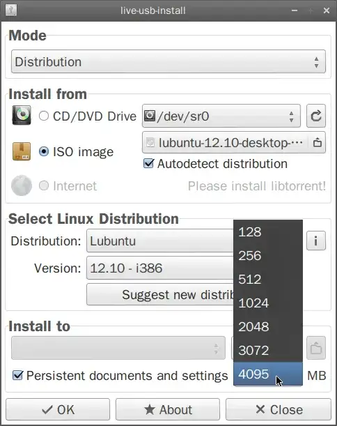

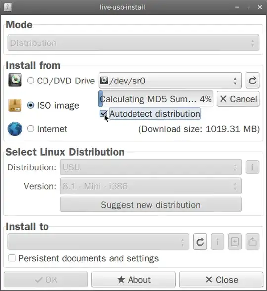

Be sure you have and always select "Persistent" option after booting from usb - if you do not see this option the usb has no persistence: it happened to me often for some reason. And to be sure that it works, I use, beside FAT32 (as stated in the other answer) a program called LiveUSB Install - here.
It provides a clear and nice interface for selecting the "persistent" boot (cannot give a screenshot of that) - it should be the second in the list after booting from live usb.
