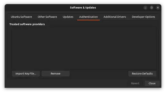

I opened up the Software&Updates App and it shows nothing in contrast to a normal Ubuntu VM
Ubuntu Trusted Software

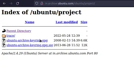

  1. Go to your repositories link in a web-browser (for example, this Ubuntu repository)
  2. dig around in the file structure for a .gpg key and download it (it might vary repo to repo) for me I found it in the /project subfolder
How the gpg file looks like

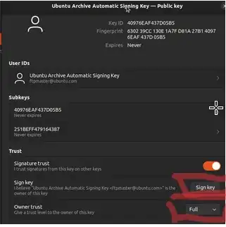

3.Double click or open the .gpg file with Passwords&Keys App,double click on the imported key and switch on the "I trust the signatures from this key and other keys" button and make sure you select Full under owner Trust drop-down menu.It should be called "Ubuntu Archive Automatic Signing key"
trusting the gpg key

you can verify this by going to the Software&Updates App and moving to the Authentication Tab :).
