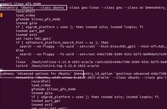

Step 5: Find menuentry followed by submenu
Here, menuentry and submenu is exactly what you see in grub menu when you boot your computer. menuentry being at position - 0, submenu - 1 enter image description here
Notice that I have menuentry 'Ubuntu, with Linux 5.15.0-1025-oracle' at position - 0 within the submenu. This is exactly what I don't want to boot to. We're going to change this.

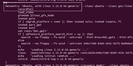

Step 6: Find the kernel that worked, within the submenu. I found mine at pos - 2 (counting from 0) enter image description here
