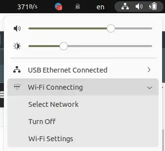

Previously the wireless connection work normally, but now it always shows Wi-Fi Connecting. Last day I installed nvidia driver and cudnn stuff for tensorflow (with errors, but fortunately fixed). I also encountered a reboot issue mentioning failed unmounting kvm exiting virtualization yesterday (but, now the error is gone). Are those problems related? How to fix this?
The problem look like this.

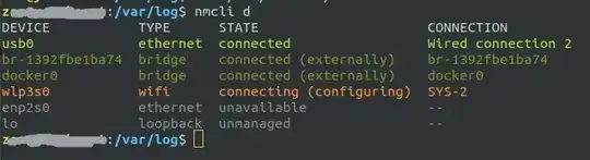

This is how nmcli d output
