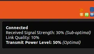

Also, in Blueman, I get this when keeping my earphones next to my laptop:
Received Signal Strength: 30% (Sub-optimal)
Link Quality: 10%
Transmit Power Level: 50%
Bluetooth signal when earphones kept next to my laptop:

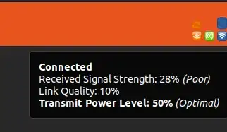

In Blueman, if I put the earphones 100-200 cm away from my laptop, I get this:
[Received Signal Strength: 28% (Poor)
Link Quality: 10%
Transmit Power Level: 50%]
Bluetooth signal when earphones are kept 100-200 cm away from my laptop:
