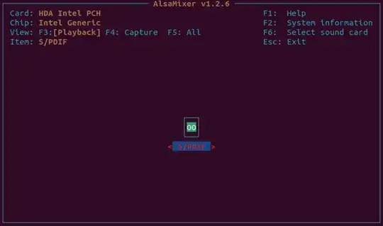

I have no sound after a fresh install of 22.04 on https://amzn.eu/d/1erCTeT
At first I had "dummy input" only and the sound card was not detected
I have updated the kernel to latest with using mainline and upgraded/updated apt
I have tried ubuntu 22.04 audio output not working (dummy audio) to add the line options snd-hda-intel model=generic to /etc/modprobe.d/alsa-base.conf
and
Sound card not detected - Ubuntu 20.04 - sof-audio-pci to change the /etc/default/grub lines to
GRUB_CMDLINE_LINUX_DEFAULT="quiet splash snd_hda_intel.dmic_detect=0"
GRUB_CMDLINE_LINUX="intel_iommu=on,igfx_off"
this has allowed something to be detected:
~$ aplay -l
**** List of PLAYBACK Hardware Devices ****
card 0: PCH [HDA Intel PCH], device 3: Generic Digital [Generic Digital]
  Subdevices: 0/1
  Subdevice #0: subdevice #0
and alsamixer shows this
pulseaudio now shows "Built-in Audio Digital Sterio (HDMI)" as the only output device but still no sound from speakers or headphones
Edit:
Some more information:
~$ lspci -v | grep -A6 Audio
00:0e.0 Multimedia audio controller: Intel Corporation Celeron N3350/Pentium N4200/Atom E3900 Series Audio Cluster (rev 0b)
    DeviceName: Onboard - Sound
    Flags: bus master, fast devsel, latency 0, IRQ 25
    Memory at 91218000 (64-bit, non-prefetchable) [size=16K]
    Memory at 91000000 (64-bit, non-prefetchable) [size=1M]
    Capabilities: <access denied>
    Kernel driver in use: snd_hda_intel
