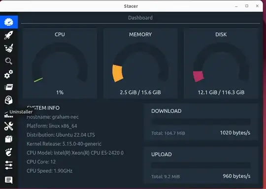

There is also the application Stacer which is available from Ubuntu Software which I use and I think pretty much matches what you are looking for.
