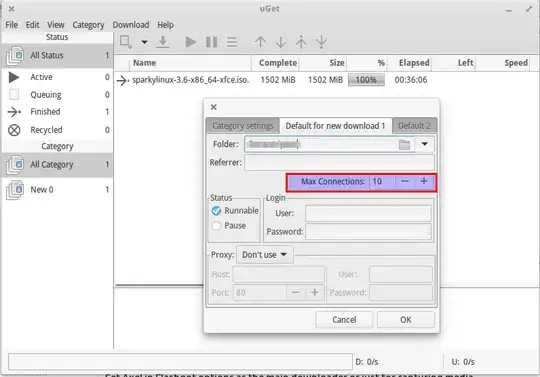

uGET uses curl and aria2 plugins to maximize speed with multiple connections. As far as I can tell, it provides the highest speeds, never reached by other downloaders, except the non-free Flareget. (Without it I would have not been able to see the top download speed of my internet connection.)
Integration with Firefox is done automatically if FlashGot in Firefox is installed.
The needed settings are:
  • Right click a category (or better All category), 'Default new download' set number of Max connections ...up to 16.

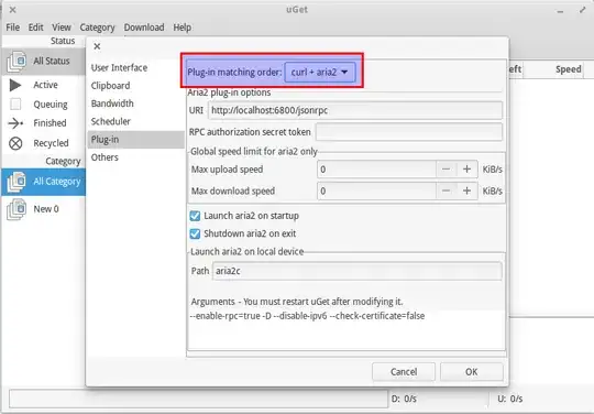

  • Edit-Settings-Pluggings, plugins matching order: curl+aria2

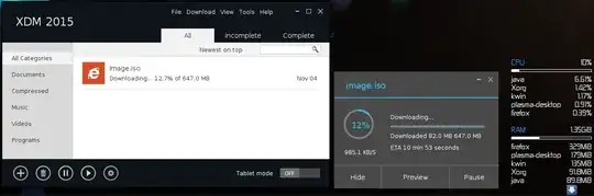

Xtreme Download Manager - was updated and looks very impressive. It can use up to 32 segments per download! - but for some reason, comparing alternatively on the same test-iso download, the 32-connection speed was significantly under that of uGet (with only 12-connections).
It uses Java and looks a bit different than IDM and uGet. It uses some memory but not too much (see the java line in the conky to the right):
It is set to start by default with the system but that cannot be disabled from within the program; so you need to disable that at system level if you want.

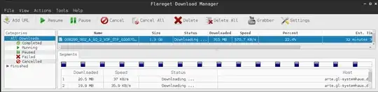

Flareget deserves to be mentioned, although the number of connections per file vary between 4 and 16 depending on the version and license. Even the minimum number of connections will significantly increase speed, but the latest versions will limit (after a trial period) to just two connections any download above 25 MB. It seems to have a smaller memory footprint.
