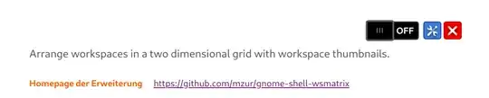

This morning I woke up to start my Ubuntu 20.04 laptop, and all of a sudden my 2x2 workspace matrix became a column with 4 rows. My anger to this random change aside, the instructions I used the last time don't work any more. As I use Chrome, the relevant extension is https://extensions.gnome.org/extension/1485/workspace-matrix/, but whenever I restart Chrome, it just looks like this:
Same on Firefox. The plugin just don't stay active.

While I found some some errors relating to the workspaces via journalctl /usr/bin/gnome-shell, it turns out the solution was as easy as switching the Extensions on again in GNOME Tweaks. This also made the slider stay switched on in https://extensions.gnome.org/extension/1485/workspace-matrix/
I can only reason that some error in GNOME caused the Extensions to fail.
