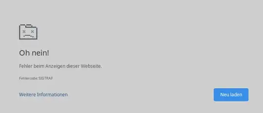

After some time (like days) i cannot open new tabs. I only get a Chromium error page showing "Errorcode: SIGTRAP". The screenshot is localized to german:

Edit: Like so many times: Just after posting i got a new clue: The Chromium snap was auto-refreshed this morning a 00:44am. So maybe that is the problem i am facing: The snap is up and running and in the background snapd updates the snap?
