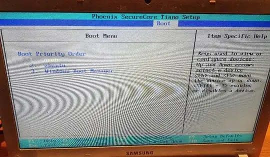

I decided to upgrade from Ubuntu 18.04 to Ubuntu 20.04. After the installation my laptop would boot to the boot device selection screen and the wrong boot device was highlighted, so I wanted to change that. I couldn't in the BIOS (after a reboot the old boot order was back), so I decided to use efibootmgr.
I ran sudo efibootmgr -o A,B,C, which was "grub", "ubuntu" and "Windows Boot Manager".

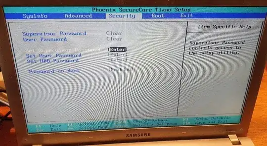

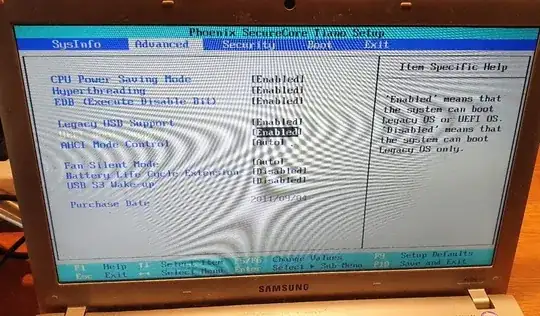

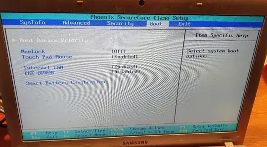

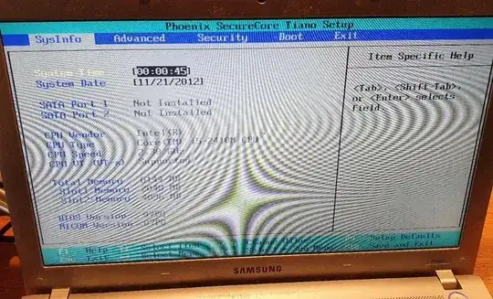

This is now the fixed boot order in BIOS. It doesn't boot anything though, but just boot loops. I can still enter the BIOS, but new boot devices don't appear (USB or DVD) and changing the boot order doesn't do anything.
