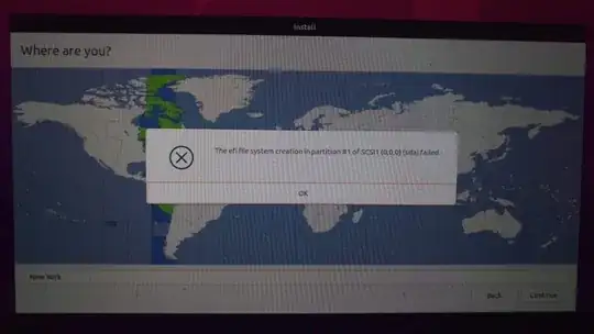

My problem is that I keep getting an error "The efi filesystem creation in partition #1 ... failed".

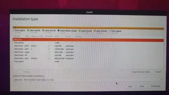

I've tried erasing the disk and selecting "something else". When I select that, this is how I configure it:
And still get the exact same error.

After trying several times, I did add every partition in different orders, and always partition #1 was the problem.
So I thought that it could be a faulty area in the disk, which effectively was the problem.
So I created a first empty partition with a few megabytes, and then all the others. And it worked.

You need to have made certain to select the partition the /boot/efi is on in that screen and said to use it as system partition I think it is worded. Alternatively in a Terminal just before starting the install, if that did not succeed as mentioned set the type to ef00 with gdisk, an example below.
