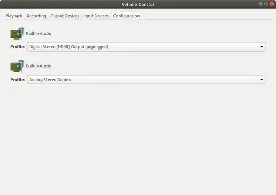

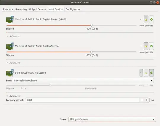

pavucontrol screenshots:
input greyed out
config looks fine

That's my built-in mic right? I don't know where to go from here.

I see in your Built-In Analog Stereo, you have it on mute (Is it not?) Click on it (the, muted speaker button) to Un-Mute it, does that help?
