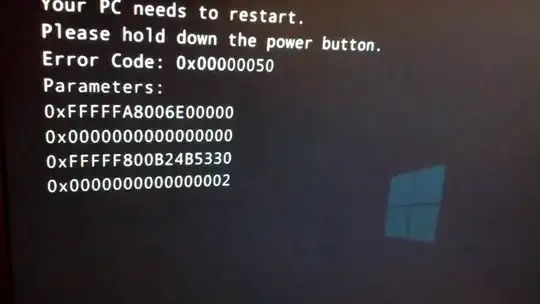

I found your question after posting my own report of the same problem at How to fix insta-crash on dual booting Windows 8 from separate drive. I was able to take a video of the crash and extract the frame that shows the error message.
