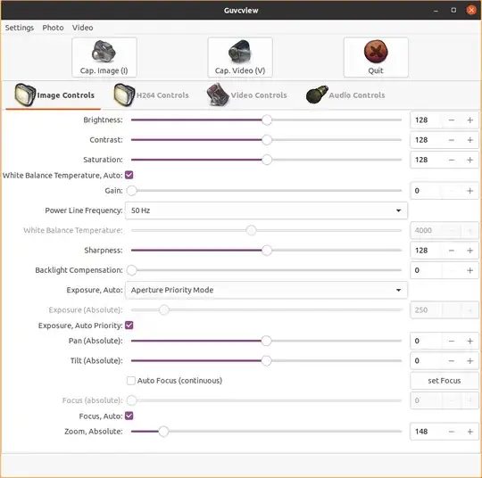

You can customize a lot of settings using guvcview.
Install with:
sudo apt install guvcview
To select which webcam to use, click in the Video tab, then select your device (Brio). In the confirm dialog, select to Restart.
Unfortunately it miss angle setting.

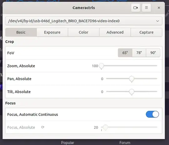

I've found the Flatpak version of cameractrls more fully featured, and easy to install.
Crucially, it has FoV support for Logitech Brio webcams
