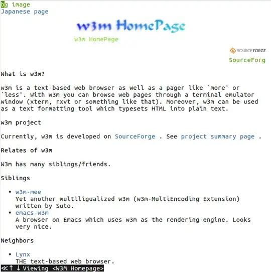

When I call: w3m https://google.com I don't see any images. How to fix it? I tried it in Tilix and in gnome-terminal.
First of all w3m-img package provides
inline image extension support utilities for w3m
so it does not have separate executable.
Then visit web-site with inline images like
w3m http://w3m.sourceforge.net
and you will get something like
w3m.sourceforge.net page
Note: it may not work on text TTY (Ctrl+Alt+F1) inside VirtualBox - I have seen this problem.
