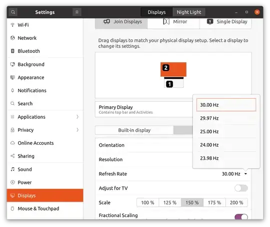

In my case, increase the refresh rate helps
I don't know why by default it set the refresh rate to the lowest value, but changing it seems to improve a lot (btw my monitor support 60hz, not sure why the max is 30 on ubuntu)

For me the issue was that I had fractional scaling enabled (found under Displays) and had set 125% scaling for my laptop screen.
Ubuntu does mention that fractional scaling may increase battery consumption and have performance issues.

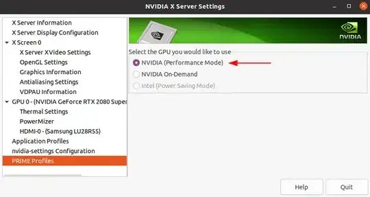

This issue occurs if you are running in hybrid graphics mode, so both of your displays are actually running the integrated (Intel or Vega, whatever) graphics driver, and the nVidia discrete card driver (or AMD) only takes over if you are run applications with the offloading.
Can't really say if this is an nVidia, Intel or Xorg or DE bug, imho it will never be fixed because developers will blame each other.
So as a solution try this: set the graphics to not hybrid (not "NVIDIA On-Demand") mode. Just choose on of the GPU to sovereignly rule the Xorg.
Assumed that you want a discrete one, so: Either via nvidia-settings: "NVIDIA (Perfomance mode)", or via prime systray indicator or if you running Pop_OS just:
system76-power graphics nvidia
and reboot.
(In this case, you will lose some of the power savings and your laptop's fan will spin more frequently)

The issue for me was I was using 'NVIDIA On-Demand' mode instead of 'NVIDIA (Performance Mode)'.
Run nvidia-settings to open the gui, then change to the 'NVIDIA (Performance Mode)' mode in the 'PRIME Profiles' tab.
credits to @superqwerty, @garbage-collection, and @Jakob. I'm adding this answer because it's been mentioned in comments and offhand in different answers but I believe it deserves its own standalone answer.

Turning off fractional scaling also helped for me in some instances.
e.g. using only 100% (or 200%, 300%, ...) scaling values.
I was often experiencing issues using 150% scaling on some of my monitors. Using a different resolution with 100% scaling seems to work better.
