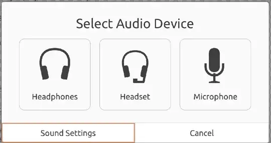

I found a better way from the Intel community forum.
  1. Open Terminal
  2. Open the alsa-base.conf file with sudo:
    sudo nano /etc/modprobe.d/alsa-base.conf
  3. Add the following line to the end of the file:
    options snd-hda-intel model=dell-headset-multi
4.Reboot
Now, when you plug in your headphones, a “Select Audio Device” dialog will appear:
"select audio device"
