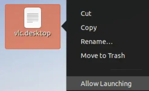

I think TheBuntuNewb's answer is pretty good. Do that using file manager:
  1. Open /usr/share/applications
  2. Copy the application shortcut to desktop
  3. Right click on the shortcut on the desktop and select Allow Launching

You can copy a file from /usr/share/applications to your desktop folder (~/Desktop) using the cp command. Then right click the .desktop file and select 'allow launching'.
An example would be
cp /usr/share/applications/nautilus.desktop ~/Desktop
Make sure to include the .desktop ending.
You might also have to allow launching for an existing .desktop file after upgrading to Ubuntu 20.04.

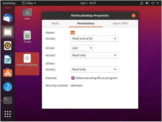

In ubuntu 20.04 you need to make the file executable first, then you'll find the "allow launching" option, anyway I can't add it to the launcher, there's simply no way to do it.

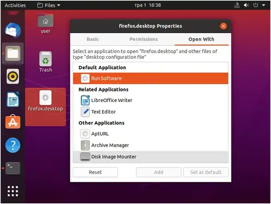

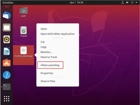

On default DE (Gnome 3) symlinking does not work, but .desktop files copying works as TheBuntuNewb said: enter image description here enter image description here enter image description here

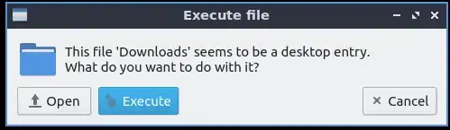

  • Downloads.desktop file which opens the Downloads directory by nautilus is created the next way:
    [Desktop Entry]
    Type=Application
    Exec=nautilus /home/user/Downloads
    Icon=folder
    Name=Downloads
In my case file properties changing is not required for .desktop file - it asks to execute it anyway:

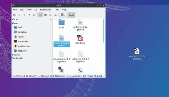

A very easy and elegant way to create a shortcut to an file or folder is to create a symlink to the desktop. I have tested this on Lubuntu 20.04 LTS
To do this do the following:
  1. Drag the file or folder from pcmanfm to your desktop enter image description here
  2. Then choose create symlink here
  3. Finally a shortcut should have been created! enter image description here
As I said before, this will probably only work on Lubuntu 20.04 (featuring the LXQt desktop)
