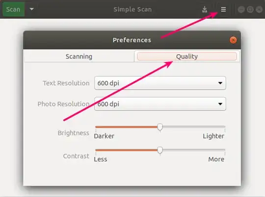

In Simple Scan select the menu (shown by top arrow) and then select the Quality tab.
Here, you can select text and photo resolution as well as adjust Brightness and Contrast. Any changes you make persist after closing the app.
