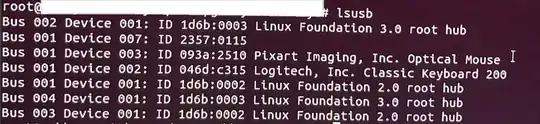

[Edit 2.] This is the output from lsusb

Good news! You can get the driver installed and working temporarily without dkms.
Please download this file and transfer it to the desktop of your Ubuntu machine: https://github.com/cilynx/rtl88x2bu/archive/5.6.1_30362.20181109_COEX20180928-6a6a.zip
Right-click it and select 'Extract Here.' A new folder will be created called rtl88x2bu-5.6.1_30362.20181109_COEX20180928-6a6a. Open a terminal and do:
cd ~/Desktop/rtl88x2bu-5.6.1_30362.20181109_COEX20180928-6a6a
make
sudo make install
sudo modprobe 88x2bu
Your wireless should now be working.
