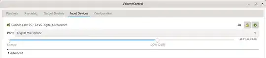

No input devices show by default on clean install of Ubuntu. I tried 18.04 (LTS) but the result is the same, so I switched back to 19.10. When I run pavucontrol it shows this:
I can see noise and that the mic is recording something (but I cannot control it from the sound settings) but it does no react to my voice.

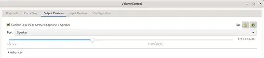

For example in my pulseaudio volume control: enter image description here and enter image description here
