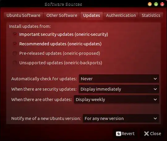

  1. open the software properties and enable universe repository enter image description here
  2. open the update manager and press check button
3.open the software center and search for ubuntu-restrcted-extras and press install button on it
enter image description here else open the terminal and type
sudo apt-get update
sudo apt-get install ubuntu-restricted-extras
