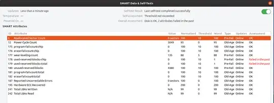

EDIT 3:
$ sudo ./magician -L
Samsung(R) SSD Magician DC Version 2.0
Copyright (C) 2015 SAMSUNG Electronics Co. Ltd. All rights reserved.
Bad argument "name", expected an absolute path in /dev/ or /sys or a unit name: Invalid argument
| Disk   | Model   | Serial  | Firmware  | Capacity | Drive  | Total Bytes |
| Number |         | Number  |           |          | Health | Written     |
No Samsung SSD found!
